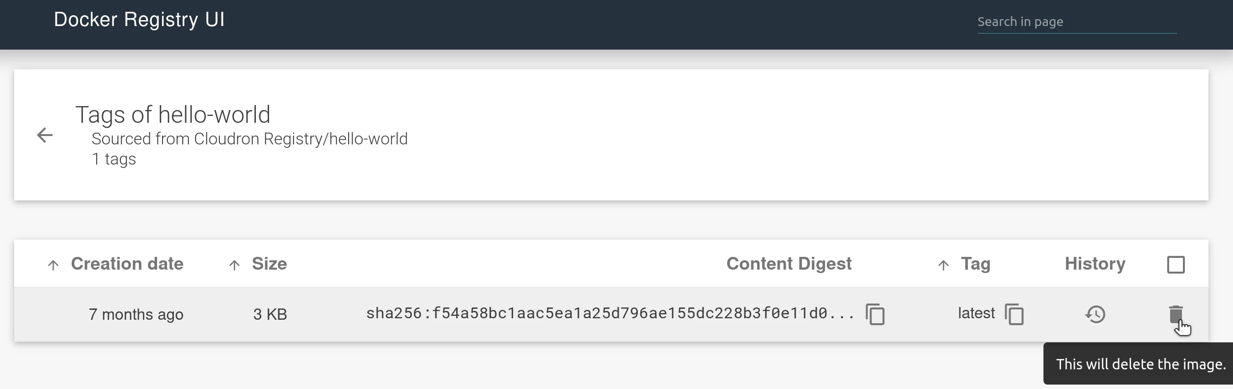

Delete tag​
To delete a tag, use the delete button in the UI.
Delete Tag
While the tag gets deleted immediately, the image blobs are not. The app is configured to run the Garbage collector every day to remove dangling blobs. To remove them immediately, run the gc command manually from the Web Terminal.
