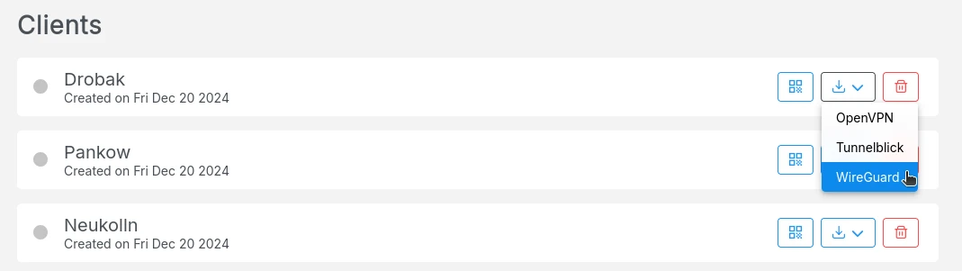

The OpenVPN config can be downloaded using the download button. There are a couple of formats:
OpenVPN- For linux and OpenVPN app on AndroidTunnelblick- For TunnelblickWireGuard- For WireGuard

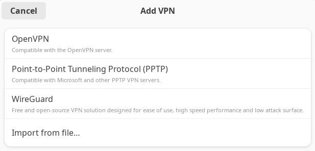

Download the .ovpn embedded certs config file from the OpenVPN app. Then, in the Network settings in Ubuntu,
click on 'Add VPN' and then Import from file....

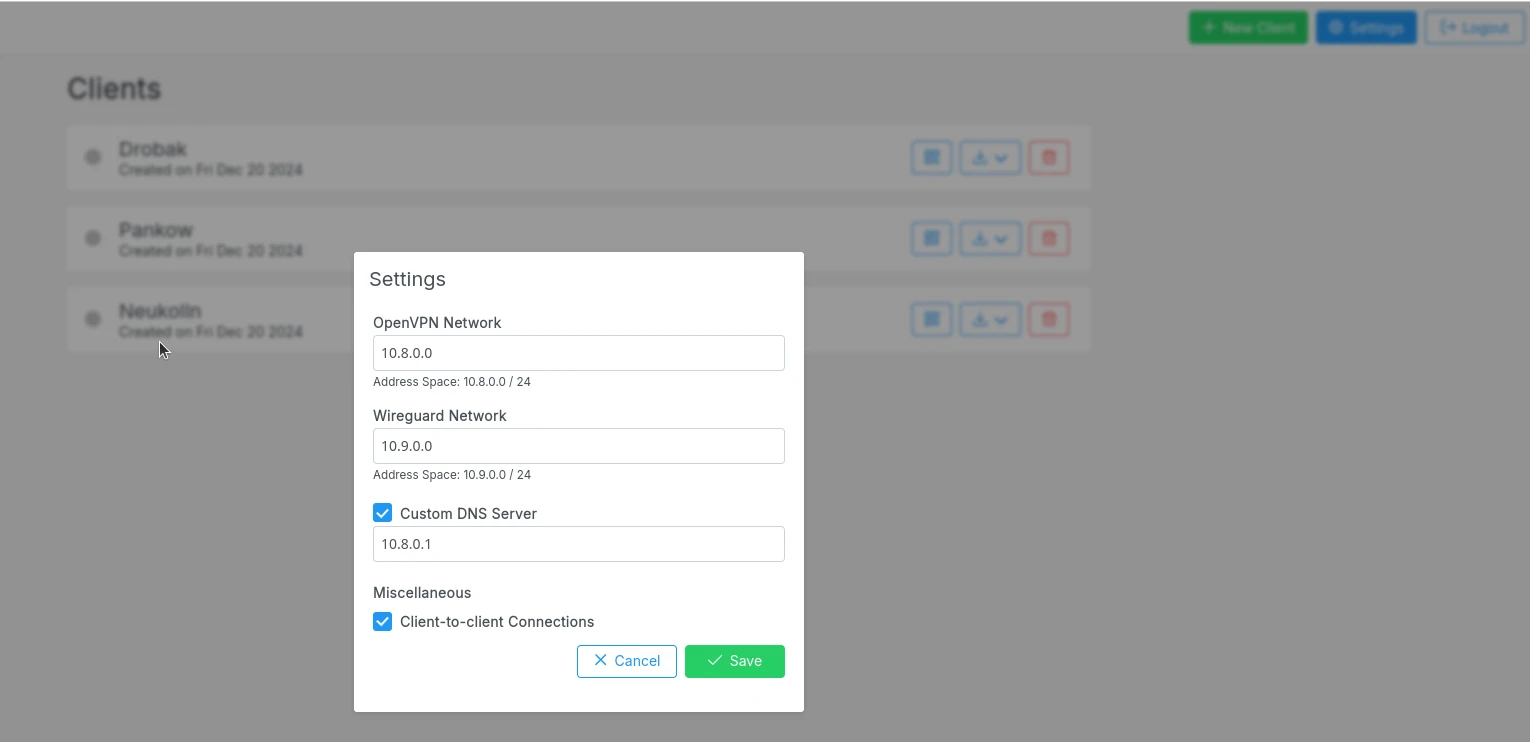

The admin panel can be used to customize some of the popular settings like the network address, DNS server and client-to-client connectivity.

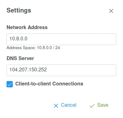

Configure the VPN to use a custom DNS server - for example, an external AdGuard or a Pi-Hole installation.
Simply put in the IP of the DNS server in the Admin Settings. In the screenshot below,
104.207.150.252 is the AdGuard DNS Server IP.

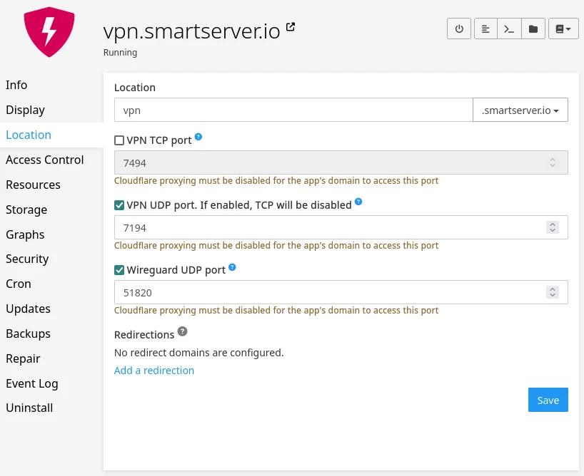

The UDP port or TCP port can be configure the app's Location section. If UDP is enabled, TCP is automatically disabled.
