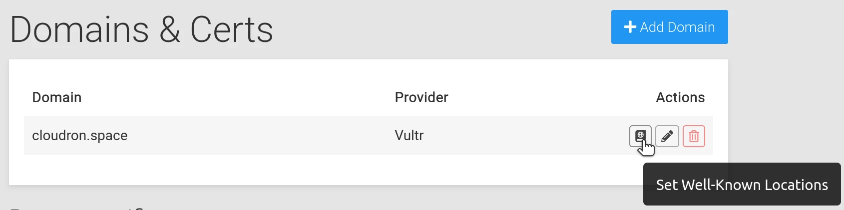

You can edit well known locations in the Domains view:
Wellknown

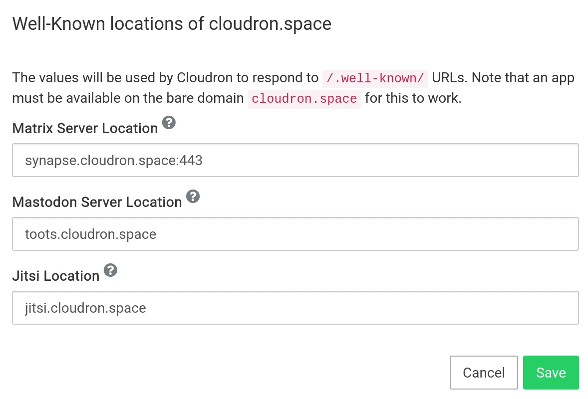

Clicking the button will open up a dialog where you can fill up well known locations:
Wellknown Dialog
Specify port 443 explicitly
The default matrix server port is 8448. However, the Synapse app on Cloudron uses port 443. For this reason, you must specify the port explicity, like matrix.domain.com:443.
