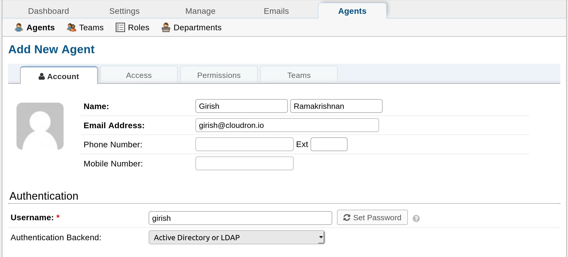

When installed with Cloudron user management, agents and end users log in with the Sign in with Cloudron button. This uses the osTicket OAuth2 plugin.
End users are created automatically on first login. Agents are not, they must be added in osTicket first. When adding an agent, set the username to the Cloudron username.
Agents that previously logged in via LDAP are migrated automatically.

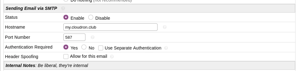

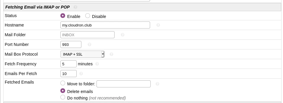

Cloudron SMTP configuration​
osTicket can be configured to process emails from mailboxes hosted with or without Cloudron.
When the mailbox is hosted in Cloudron, you can use the IMAP+SSL at port 993 for receiving Email:
Imap
To send email, use port 587:
Smtp
